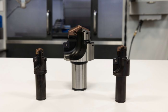

Indexable porting tools offer a solution. One example of an indexable tool is the AccuPort 432, which performs multiple operations in a single step while allowing you to simply swap out worn inserts and return to production. Indexable tools like this provide excellent repeatability and surface finish while eliminating lost production time due to pre-drilling setups and regrinding. With four-in-one tools, not only do you get the tap drill size required, seal angle diameter, form and spot face, but you can also drill from solid.
With indexable tools, there are many benefits when performing port cutting applications. Exemplifying this is the ability to use a particular geometry to create a better chip in the elastic materials often encountered and, therefore, create a better finish. In addition to optimizing the inserts on the front of the tool for whatever material you are drilling, using point geometry can help reduce thrust and keep the tool centered as you guide it through the cut to get the tight tolerances required. Port form inserts are also replaceable and are often available in different substrates depending on the material. As you can see, the different functions as far as the drill tip are all based on material with geometries available for whatever material you are drilling.

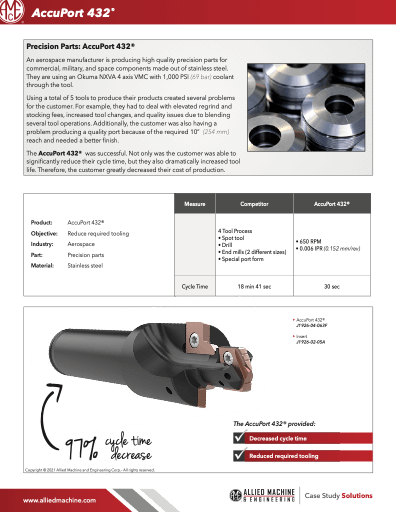

The products in Allied Machine’s AccuPort 432 product line are designed to deliver maximum performance in a diverse range of hydraulic port cutting applications and numerous industries. Indexable tooling such as this can provide a more cost-effective and higher performance solution anywhere a hydraulic port is required in a fraction of the time taken for traditional methods using separate drills, special forming tools and spot facers. These innovative designs deliver the best possible range of benefits in terms of productivity, cost per hole and tool life. Read on to see the real-life results of an indexable port cutting drill.
