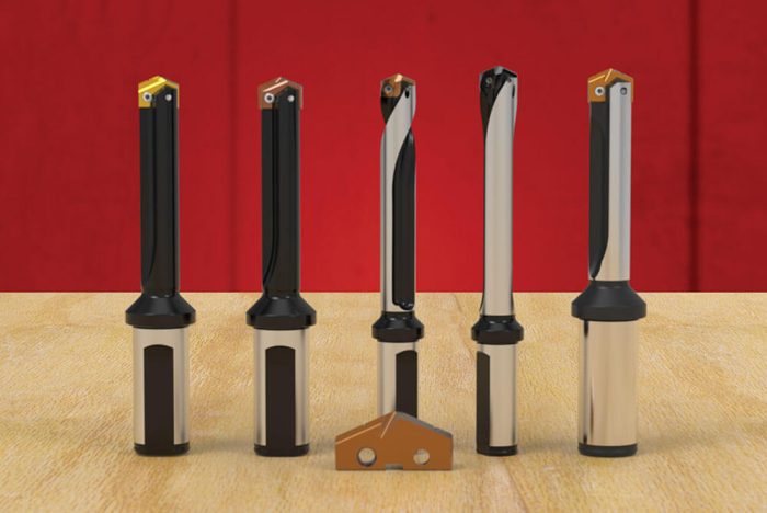

Each type of drill—replaceable insert, solid carbide, and indexable insert—all have a place in a machine shop and can all produce successful applications, but replaceable insert drills, often referred to as spade drills or replaceable tip drills, have their own set of advantages when holemaking in metal. If you’re thinking about adding replaceable insert drills to your cutting tool lineup, here is what you need to know.
What makes it a replaceable insert drill?
Engineered to allow machinists to quickly change out worn inserts, replaceable insert drills are made up of drill bodies and inserts available in a wide range of diameters and body lengths. Additionally, through a combination of cutting-edge geometries and coatings as well as carbide versus high-speed steel inserts, you can create an application-specific solution, allowing you to control multiple aspects when machining in metal to achieve the desired outcome—establishing the best spade blade insert for your application needs.
Still though, you may be asking what is the difference between indexable or IC drills and spade drills besides the insert design itself? Replaceable spade inserts are an effective method to drill a hole in your workpiece and provide additional cost savings as well. There are many different geometries, shapes, sizes, substrates, and coating variations that can be used when considering a replaceable spade insert for an application based on what the specifications are and what is being requested by the customer regarding cycle time, cost, tool life, etc.
When using a spade drill insert, it’s key to have a decent milled surface or in some cases pilot hole to enter on because it allows the insert’s point to start on an even surface and begin the process of drilling—all of which allows the tool to drill a good sized, straight hole. If these starting conditions are not there, you risk having the tool walk or lead off from where the hole needs drilled.
Indexable drill inserts provide a broad range of cutting-edge geometries, sizes, configuration, substrates, and coatings and are oftentimes combined with a replaceable insert in holders to serve as multipurpose, one-shot solutions for some applications. When used alone, an indexable carbide drill now serves as a roughing tool that is durable in the fact that it will be able to handle interruptions, cross-holes, fly cutting, and entering in and exiting angled surfaces like castings. Ultimately, it does not need the decent milled surface because it does not have an angled point and its geometries usually engage the part first away from the center of the tool. Indexable tools are run at higher RPMs and lower feed rates and with durable carbide inserts can withstand some of the irregular applications commonly seen.
Ultimately, these tools can handle a fair amount of abuse that a spade insert would not be able to, so indexable insert drills would be the first choice when the initial application is presented as rough, irregular, angled, has interruptions, etc. and when the hole diameter and depth is within the range of the IC tool.

From automotive to heavy equipment to firearms, replaceable insert drills excel in a wide range of industries and applications. These drills also work well in medium-sized job shops as well as high-production facilities. Specifically, the long-term, repeatable process of high production runs benefit from the investment in replaceable insert drills because the overall cost per hole is reduced. Compared to the cost of new solid carbide tooling, the initial investment of the insert holder or drill body is quickly compensated through reduced cycle time and cost of simply replacing inserts.
Whether looking to drill through hardened steel or sheet metal, the ISO-specific geometries often available for replaceable insert drills provide an ideal solution for applications in metal. For example, a P geometry insert is great for low to medium carbon steels, alloy steels, as well as tool steels while a K geometry insert is ideal for both nodular and ductile cast irons. N geometry inserts target cast and wrought aluminums, even copper and brass, and M geometry drill inserts are designed for ferritic and austenitic stainless steel as well as high strength super alloys like Inconels and titaniums.
Replaceable spade drills are also used for more challenging deep hole drilling jobs because they are pointed, which helps with straightness, and have longer margins, which helps improve stability. Machinists running these types of applications should reference deep hole drilling guidelines to establish a centered, straight, and round pilot hole and prepare for the full to depth drill in addition to ensuring user safety when drilling.
