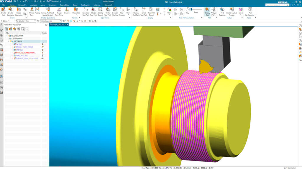

NX CAM
The automated Deburring operation in NX CAM has been expanded to include multi-axis milling capabilities. NX automatically recognizes the edges of parts with any level of complexity, and then creates multi-axis operations to machine the specified chamfer size.
Depending on the part geometry, you can quickly create different multi-axis operations, such as 3+2-axis, 4-axis rotary and 5-axis machining. You can also use different cutting tool types, including ball, taper or lollipop tools. The advanced controls help you define the cutting pattern, tool axis and tool motions, resulting in smooth and optimized machining operations.
The automated multi-axis Deburring in NX CAM helps you reduce the programming time, while outputting optimized toolpaths for highly efficient machining.

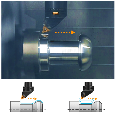

PrimeTurning is an innovative machining method. Siemens partnered with Sandvik Coromant to implement PrimeTurning in NX. This cutting methodology that uses high-performance CoroTurn Prime inserts enables higher performance machining.
When using the PrimeTurning technique, the tool enters the workpiece at the chuck and removes material as it moves towards the end of the component, away from the chuck. This enables use of a small entering angle and more aggressive cutting parameters. Furthermore, you can use the CoroTurn Prime inserts for conventional turning – from part-end towards the chuck.
With NX, you can also setup a PrimeTurning for a dual roughing operation (Multi Channel Roughing) and you can use it in conjunction with continuous B Axis.
For certain applications, PrimeTurning can help you increase productivity in excess of 50%, compared to using conventional techniques and inserts. Additionally, it can the extend the tool life by 2 times.
PrimeTurning is an innovative machining method that enables more aggressive cutting parameters, resulting in 50% higher productivity.

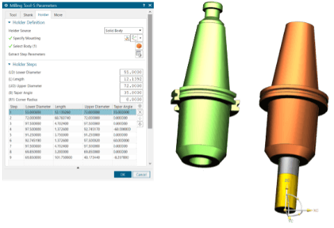

Automated Holder Creation. Tool vendors typically provide 3D models of their tool holders. However, these 3D models can’t be used directly for NC programming in conventional CAM systems. It requires that the programmer manually input the tool holder parameters, such as the diameters and lengths of tool holder’s sections. This manual process can be time consuming and is prone to errors.
The new Holder Creation capability automatically recognizes the features and associated dimensions of the 3D holder solid models provided by cutting tool vendors. It automatically populates the holder parameters in NX, accelerating NC programming and enabling accurate machining simulation to achieve error-free production. You can also export the holder (along with its parameters) to the tool library for future re-use. The automated holder creation helps you speed up the NC programming of collision free toolpaths.
NX CAM helps you automatically recognize the features and associated dimensions of the 3D solid holder models imported from tool vendors’ catalogs.

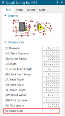

The Tolerance Class field has been added to the dialog of reamers and boring bars, enabling better alignment with tool vendor data. You can leverage this information for Feature-Based Machining.
The Tolerance Class field has been added to the dialog of reamers and boring bars (shown above)

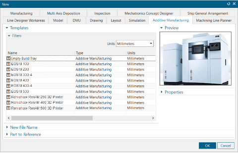

Print drivers for EOS and Renishaw. The NX Additive Manufacturing application now integrates a new build preparation functionality dedicated to EOS and Renishaw printers.
NX enables users who already have both NX Additive Manufacturing and EOSPrint or Renishaw QuantAM API to prepare print jobs within the NX Additive Manufacturing environment.
This delivers an integrated and associative additive manufacturing process – from design to 3D printing on EOS and Renishaw machines, including:
  • Generating output files in .openjz or the .task formats (available only for physical EOS 3D printers)
  • Configurable build tray dimensions
  • Selection from multiple slice thicknesses
  • Selection from multiple build strategies (per build tray; override per part)
  • NX AM build-in capability for complete layer/stack representation (under toggle)
NX Additive Manufacturing provides a new integrated build preparation functionality dedicated to EOS and Renishaw printers.

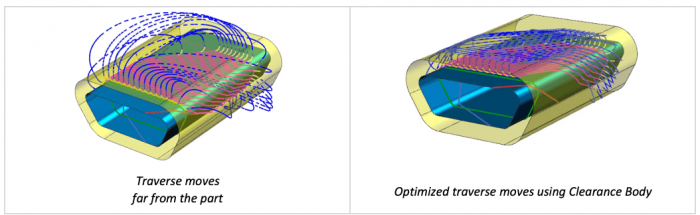

The Clearance body setting provides an additional way to control the traverse moves. Often, when working with large parts with a lot of shape variation, the traverse moves in some areas can be unnecessarily far from the part. This is especially prevalent when working with robotic applications and manufacturing large parts. Now, you can use a solid body or a surface as a clearance plane to define traverse moves that are closer to the part, enabling:
  • More efficient traverse
  • Less kinematic movement
  • Smoother traverse moves
The Clearance Body is a new technique that uses a surface or a solid body as a clearance plane, ensuring that the traverse moves of multi-axis additive operations stay closer to the part.

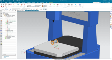

NX CMM Inspection Programming
The CMM programming capabilities in NX CAM enable NC programmers to perform CMM inspection programming, a new trend in the industry. This helps consistent workflow for CAM and CMM programming, enabling a higher level of process integration.
Note that the NX CMM Inspection Programming product will be available with its full functionality, and the CMM capabilities in NX CAM are offered as a parallel solution.
Program CMM inspection operations in NX CAM.
Object transform helps you quickly create CMM inspections paths for symmetric parts and repeating features. You can mirror and copy inspection paths to further streamline and standardize the process of inspection programming.
Quickly generate inspections paths for symmetric parts and repeating features using the new mirroring capability in NX CMM Inspection Programming.
