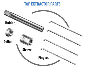

A tap extractor can be a life saver. They allow you to remove broken taps without having to drill or use an EDM and can help you avoid significant damage to the threads (if used correctly). Tap extractors have fingers that slide down into the thread and grasp the tap so that the broken tap can then be pulled out. It is important to be thorough and taking your time during the tap extraction process.

1. Insert the tap extractor into the flutes of the broken tap
2. Push the holder piece downward so that it touches the broken tap
3. Slide the sleeve down until it touches the workpiece.
4. Use a tap wrench to twist the end of the holder forward and backward to loosen and remove the broken tap.

1. The fingers of the extractor must align with the flutes of the tap
2. Move slowly and be gentle
3. Clear any chips that could block the entry
4. Get the extractor fingers as deep into the hole as possible
Taking these precautions will increase the likelihood of having a successful removal. For example, a broken tap can be wedged out ¼ of the way and then gets stuck on a chip and becomes re-stuck. It is also important to note that there are situations where a tap extractor will not come to rescue. There are cases where the tap is too tightly buried in the for a tap extractor to salvage it.
