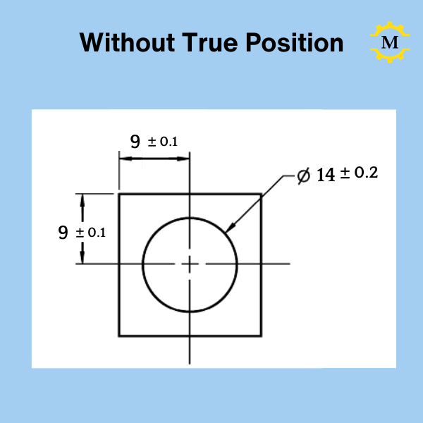

In drawing #1, we can see the “classic” dimensioning specifying the positions of a bore. The tolerance on the position of the bore is controlled for each axis separately and does not depend on the bore’s diameter.
Drawing #1

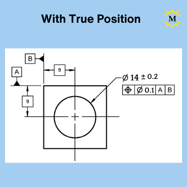

Drawing #2, shows the same part with the use of the true positions symbol.
  • The position is denoted inside a box and without a tolerance.
  • The position must always refer to a datum (▲), usually a plane or a cylinder.
  • The tolerance on the position (in our case 0.1) defines the permissible distance of a feature’s location from its “ideal” position.
Drawing #2

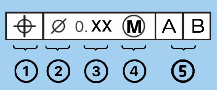

True Position Notation
  1. True Position symbol: It means that all the preceding symbols and numbers correspond to a true position tolerance.
  2. Diameter Symbol: If present, it indicates that the feature and tolerance are diametrical. True position is most often used on holes and, therefore, will include the diameter symbol. In such a case, the position deviation is multiplied by two. (see formula). If the feature is a slot, then this symbol will be omitted.
  3. Position Tolerance: The maximum allowed deviation from the theoretical position.
  4. Material condition: If a material condition is indicated, you can add a Bonus tolerance to the allowed deviation (3). (True position is typically paired with MMC)
    1. M – MMC – Maximum Material Condition.
    1. L – LMC – Least Material Condition.
    1. Omitted – No material condition.
  1. Datum: The datum planes (or axes) from which the position is measured.

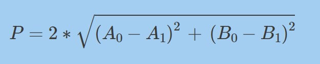

True Position Formula
  • TP – True Position. Maximum allowed positional deviation (0.1 in our case).
  • A0,  B0 – Theoretical required feature’s position (9 for both in our case).
  • A1, B1 – Measured position.
  • P – Position deviation from the nominal.
  • D0 – Nominal diameter of the feature (14 in our case).
  • T – Features tolerance (0.2 in our case).
If P<=TP, the feature is within the permissible position envelope. If P>TP, Then the position is non-conforming.

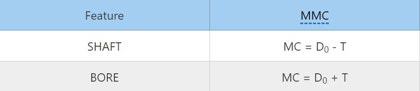

Usually, ture position is paired with MMC (Maximum material condition). In such a case, the calculation should proceed as follows:
  •  Obtain the Material Condition (MC) according to the formula in table #1 (depending on your feature type).

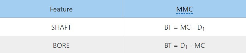

  • Obtain the  Bonus Tolerance (BT)  according to the formula in table #2.
  • Calculate the final True Position TP=TP+BT
Table #1
Table #2
