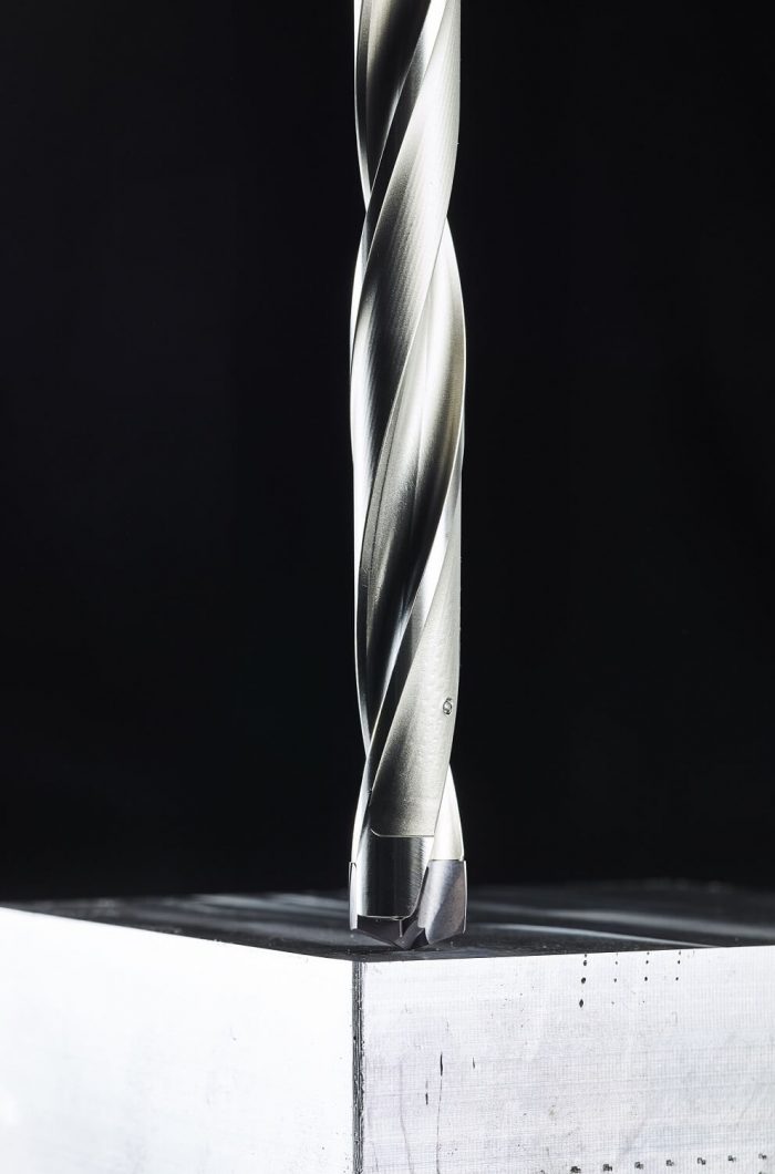

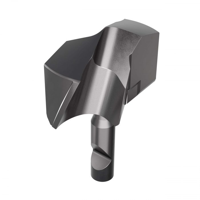

WIDIA™ announced today the release of a new MS geometry insert for the brand’s best-selling TOP DRILL™ Modular X (TDMX) drill. With the MS geometry expansion, the TDMX platform now offers three material-specific inserts, broadening the platform’s application capabilities to include inclined entry and exit, stacked plates and cross-hole drilling in stainless steel, super alloys, steel and cast iron materials.
The MS geometry insert for the TDMX modular drill platform provides increased stability when drilling stainless steels and super alloys.
“The launch of the MS geometry insert for our TDMX portfolio gives customers a versatile tool for multiple workpiece materials and applications,” said Ashokkumar D., WIDIA Global Portfolio Manager. “This new MS geometry is designed to perform in different types of stainless steels and super alloys making it an ideal choice for customers looking for excellent stability and reliability in general engineering and energy machining operations.”
In a recent customer test, the TDMX body, paired with the new MS geometry insert, achieved a 60 percent increase in tool life versus competing solutions while machining a 13-8 Hyper Chrome 110 KSI workpiece material at 3XD with a cutting speed of 75m/min.
The TDMX modular drill features a double angle pocket seat design and a flanged shank that provides outstanding flexibility and stability.
The drill’s “X”-shaped pocket, and tapered seat provide stability in challenging applications while making it easy to change out the insert without disassembling the body from the holder. These key design features reduce unstable cutting conditions experienced with other drills commonly available in the market today, while enabling higher penetration rates and reducing overall machine set up times and costs.
All three inserts can be reground to extend the life of the tool. TDMX is available in both imperial and metric sizes in 1.5xD, 3xD, 5xD, 8xD, 12xD and diameter ranges 16 to 40 mm. Orders for the TDMX and MS geometry insert as well as other WIDIA metal cutting tooling can be placed through WIDIA authorized distribution partners.
