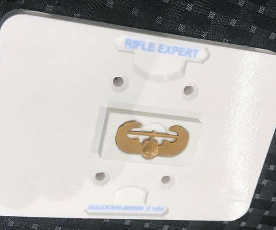

Ira Green Inc. makes accoutrements for military uniforms, such as medals and pins. 3D-printed fixtures ensure the accuracy of nail placement while cutting down significantly on both the time and cost of designing and building fixtures. The machine’s ink-marking capability also adds three points of verification to prevent errors. (Image courtesy of Ira Green.)

Precision is critical. The 3D-printed fixtures hold the piece while it is being nailed in the welder and ensure the precision and accuracy of the nail placement. This speeds the process because it eliminates the need for repeated manual adjustment of the fixtures. It also saves time from machine operators placing one nail at a time using traditional machining. Using fixtures printed with the Rize One machine, IGI has been able to standardize the center of the fixture for nailing the piece without requiring adjustment.
Since implementing 3D printing less than a year ago, IGI’s design team has printed approximately 300 fixtures. It now uses the Rize One 3D printer every day to reliably manufacture fixtures in 50 minutes at a cost of $2 per part. This enables IGI’s design team to produce seven different versions of fixtures per day that can be used for welding and polishing. Using the Rize One, IGI is able to standardize the molds and the nails, resulting in faster setup and change-over, repeatability, and increased accuracy. Mr. Yehle says the shop has realized an 80 percent time savings in setup and change-over times and has virtually eliminated errors.
Besides speed and accuracy in making fixtures, IGI’s designers have found use in the Rise One’s ink marking capability. They use it to print work order numbers, line numbers and pictures of the piece on the fixtures for identification as well as instructions for part use and storage. These markings also serve as three points of verification for machine operators to prevent errors.

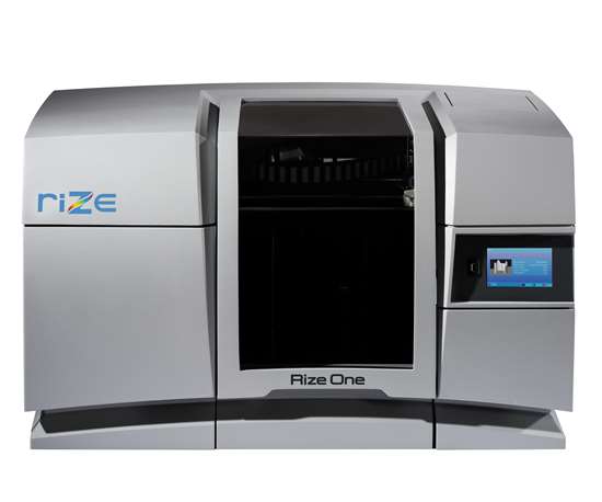

The Rize One 3D printer is what IGI uses for its ficturing and prototyping work. The system uses what Rize calls augmented deposition, a hybrid of extrusion and jetting. The machine jets a release agent between layers for cleaner removal of support structures. Jetting also enables the ink marking capabilities that IGI takes advantage of for printing work order numbers, line numbers and pictures of the piece on the fixtures for identification as well as instructions for part use and storage.
